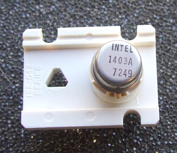

can anyone that collects early Intel tin cans please provide me with lot & date code marked on ones they have.
hopefully the response will be a bit better than lot codes on dips thread
for example my 1403A has these codes 7249 & 8116
one code is normally on top & the other is marked on the side
