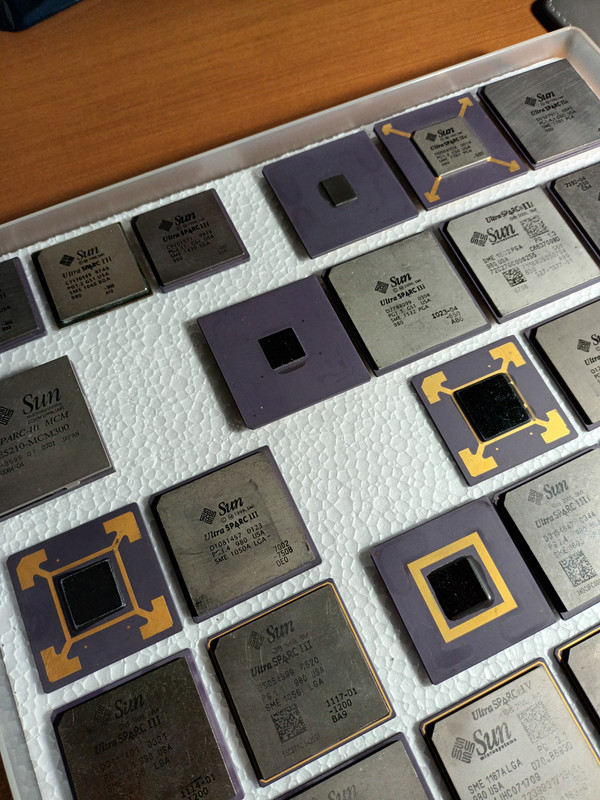

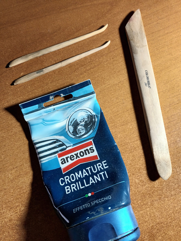

It is not an exact science and there are no manuals to do it, each collector has developed his own method that is the result of years of experience and many failed attempts.
Mine is to heat the part and remove it with wooden chisels that do not leave marks on the ceramic, when most of it is removed you finish with a polishing paste for chrome plating.
ATTENTION! at this stage you must cover the gold parts and the writing with paper tape so they are not damaged.
in the photo you can see the result in the SPARCs that have a similar cement, the final result is not bad.
