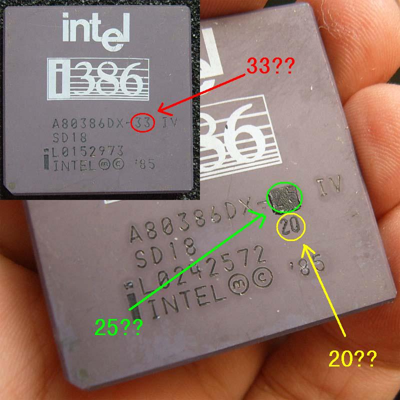

Can these marking (SD18, SC21, other known ?) be considered as sSpec or not ?
PostPosted: Tue Nov 07, 2006 7:48 am    Post subject: Reply with quote
I treat them as a sspec until I know otherwise for sure.
bacterio
Joined: 04 Dec 2005
Posts: 242
Location: Getafe, Espaņa
PostPosted: Tue Nov 07, 2006 2:37 pm    Post subject: Reply with quote
I think that them aren't sspec because for example the SD18 refers to three diferent speed 386 (DX20, DX25 and DX33)
PSP Slim 3.71 M33-4 Very Happy
PostPosted: Tue Nov 07, 2006 2:38 pm    Post subject: Reply with quote
the only SD18 I have is DX-25
do you have links to the other speeds?
PostPosted: Wed Nov 08, 2006 3:00 am    Post subject: Reply with quote
Mine is 20 MHz.
PostPosted: Wed Nov 08, 2006 3:01 am    Post subject: Reply with quote
My SD18 is clocked at 33 MHz ! Shocked

PostPosted: Sat Nov 11, 2006 4:45 am    Post subject: Reply with quote
i have 25 reformat to 20
Who do reformat?intel?
