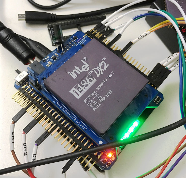

I could not resist any longer and I was brave enough (or stupid enough) to plug some of my DX2-66 ES on the alpha PGA UCAS.

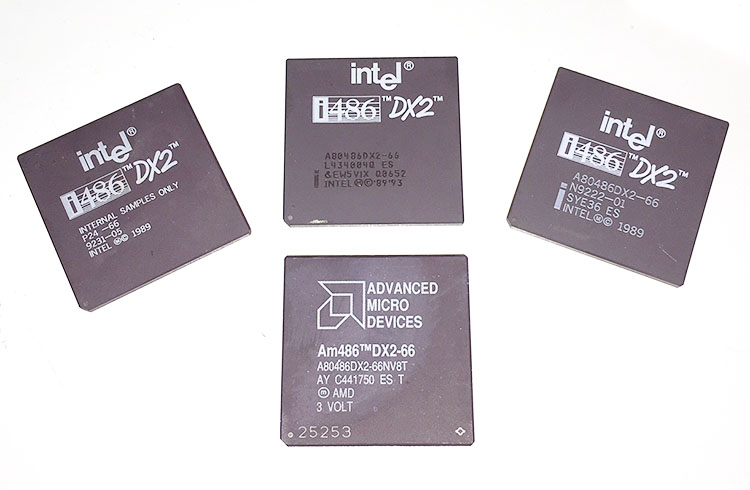

Good news : all of them work properly! I grabbed some informations about four or them :
The Intel "Internal Samples Only" CPUID is 0x433. It doesn't support the CPUID instruction. So it's basically a B1-Step, similar to the commercial SX645. Would have expected an A-Step, but nope.
The Q0652 supports CPUID instruction with CPUID = 0x436. Late DX2, ES counterpart for SX955 (w/ Write-back).
The SYE36 ES is basically the same than the "Internal Sample Only" : no CPUID instruction support with CPUID = 0x433.
The AMD A80486DX-66NV8T don't support CPUID instruction and ID itself as 0x432.

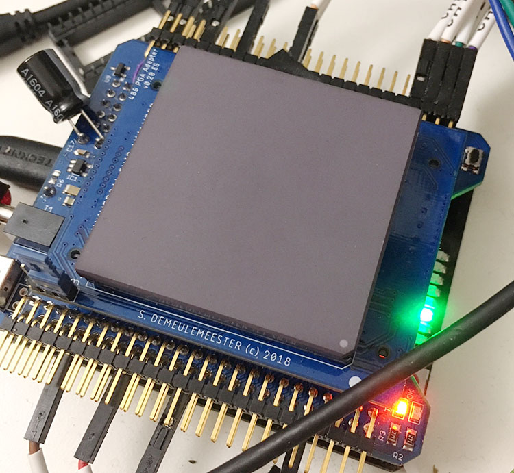

I also found near them on the tray one blank 486 that I have never been able to identify. It don't boot on a 486 motherboard. Can't remember where does it come from, but probably a Journey kit.
Plugged on the UCA, it worked for 2-3 seconds @ 8 MHz before crashing horribly with multiple failures. But it was enough to grab ID information. This is indeed a 486 that supports CPUID instruction and ID itself as 0x480. So it's a defective early DX4-100 (without WB).
