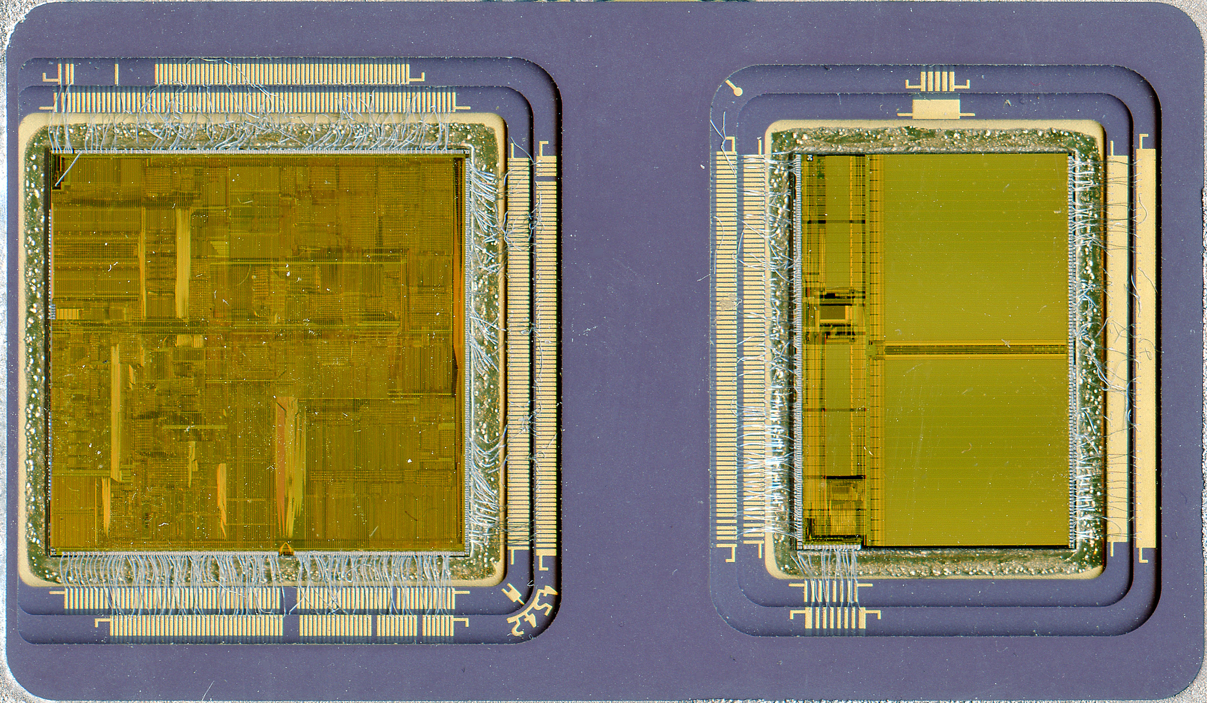

I have an A0 P6 without lid. Wait a minute, I'll scan it...
PostPosted: Wed Jul 03, 2019 11:30 am    Post subject: Reply with quote
Here it is. Click for super high def.
P6 A0 W/O lid

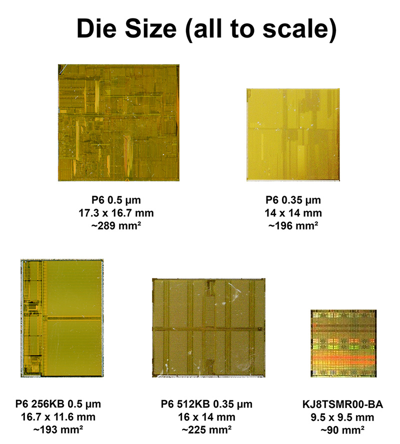

I scanned everything and put all the dies to the same scale, then measured them all. Check that :
The KJ8TSMR00-BA die (almost sure built on 0.35 µm) is way too small for anything related to P6. :-/

I don't claim A8CNIC is the CPU because I don't know and I don't have one. But I have a KJ8TSMR00-BA and we have only speculations about its relation with P6. But it makes not sense for Intel to build a special costly "test CPU" in Q2'1996 for the P6 µarch because they already had working samples for it. More, at that date, they works on Klamath. P6 was finished long before.
Fact about KJ8TSMR00-BA is the die inside is way too small to be 512 or even 256 KB of cache. The pattern also doesn't match, with too much logic and too few SRAM cells. It seems to be a small cache (64/128 KB) with a high speed bus. Like the one needed for RAID controllers or NIC.

A 256 KB cache built on 0.35 µm would require ~135 mm² of die space. The KJ8TSMR00-BA die is only 90 mm². So it's impossible to have more than 128 KB of SRAM inside.
This said, Klamath uses 4x 128 KB chips, but these IC were outsourced to Toshiba or NEC. And they have much less pins.
Maybe these IC are related to some kind of supercomputer. :-/
PS : With the last picture you posted, there is no doubt that your IC is an external Pentium Pro cache IC. Pity there is no date code, but it's probably much older than KJ8TSMR00-BA :-/

I didn't take the time to put mine to scale. Doing so like you did definitely proves that the KJ8TSMR00-BA ES isn't a 512K Pentium Pro cache. A 128K 0.35 µm cache seems plausible, but what would have been the purpose?
