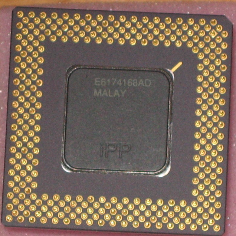

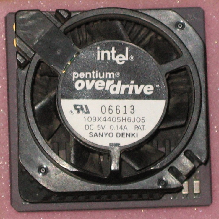

Hi,
This looks like an intel pentium overdrive, but the markings on the inside suggest that it is an boxed version of a Pentium 166 MHz.
Is it the overdrive or is it a strange boxed version?

Its a ordinary boxed pentium with a fan from a Pentium overdrive.
If you look at these Pentium overdrives they have the same connectors and fittings as yours.
http://www.recode.se/cpulibrary/Intel/Pentium/Overdrive/library.html
Edit:
After a second look i think i have to take that back. That is no ordinary boxed P166.
The heatsink is like those on a overdrive and there are capacitors under it which no boxed pentium has. The "166" should be in the lower right corner and there should be a "BP80502166" in the bottom.
Strange chip...

| I agree with your second look. The fan of an overdrive does not fit a normal boxed processor, because the latter does not get its power from the chip. |

It could be a remarked/fake Pentium 166 Overdrive (PODP3V166). I have looked around on several images and the PODP3V166 has 166 in the top right corner, the black cap at the bottom and the overdriver heatsink. _________________ My collection: http://www.cpucollection.se :::::: http://www.chipdb.org Photos of chips you never knew existed. Now over 6000 different chips in the database. |

That would be an explanation. I don't know what the origin is. I bought the chip from a seller in the UK.
Are there more known cases of remarked Pentium Overdrives?
Besides, what is the point of remarking processors? |

In this case perhaps someone earned some money. Bought cheaper overdrives and remarked them as newer Pentiums. If you made $20-30 on each cpu and did it to 1000 pcs, that is a real profit.
(This is just speculation, im not sure if the overdrive came first or not and then where cheaper.)
I have not heard of any Overdive remarks. _________________ My collection: http://www.cpucollection.se :::::: http://www.chipdb.org Photos of chips you never knew existed. Now over 6000 different chips in the database. |

Have you got a system you can test it in? If it's an overdrice processor, the CPUID code will start with 15xx, if not then it will start with 05xx. SU072 ahs CPUID of 052C.... _________________ My graphics card database can be found at http://www.gpuzoo.com.

I don't think it's fake. It should be very difficult to remark the processor speed in the top right corner of the chip. Laser markings on fake processors are either sanded or painted over. These techniques will be noticable on overdrive processors, as it's not possible to sand, or paint the whole surface of the chip.
It's possible Intel had very high demand for boxed processors, or low demand for overdrive processors so they marked some of overdrive processors as boxed processors.

| gshv wrote: | I don't think it's fake. It should be very difficult to remark the processor speed in the top right corner of the chip. Laser markings on fake processors are either sanded or painted over.
Gennadiy |
In this case the originating chip also says "166" so there are no remarking to be done there.
But yes, this could a Intel remark as much as a fake.

I suspect that overdrive 166 processors were more expensive than boxed Pentium 166 processors, so there was much sense to remark them.

| gshv wrote: | I suspect that overdrive 166 processors were more expensive than boxed Pentium 166 processors, so there was much sense to remark them.
Gennadiy |
Yes, i was unsure about that. If at the time the overdrives where more expensive then it is probably a intel relabled one.

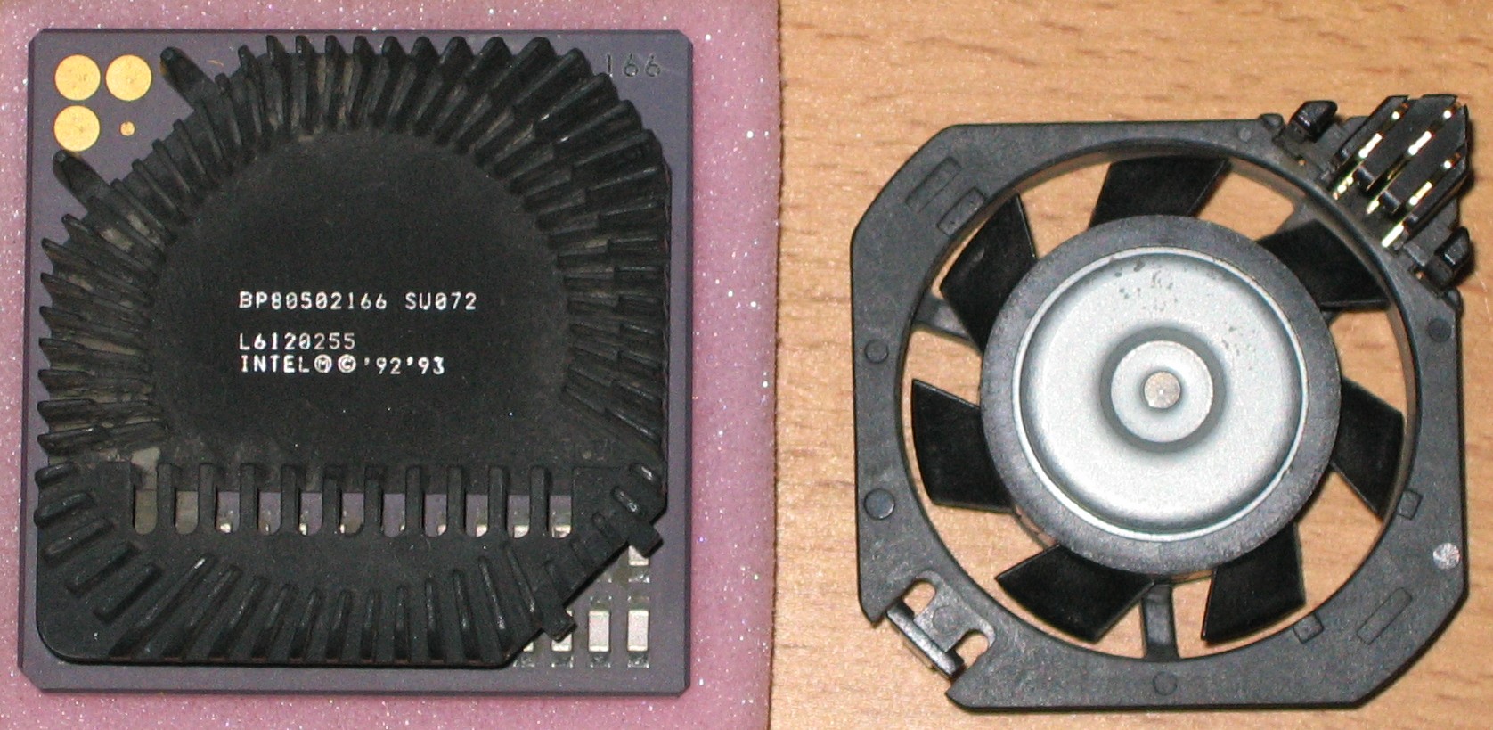

Hey - now that is cool.
Here is my SU072
My guessing is that it is not an SU072 CPU underneath, it is infact an "Intel Overdrive" With the PODP5V fan on top.
The heatsink is definately the wrong one for the chip. _________________ 4000+ chips.
